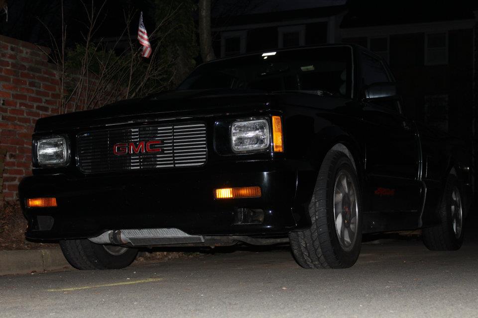

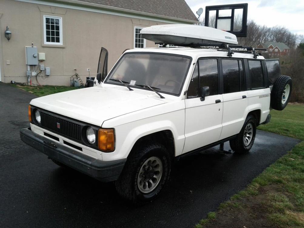

The pic is my new trooper and my other toy, 1991 GMC Syclone.
