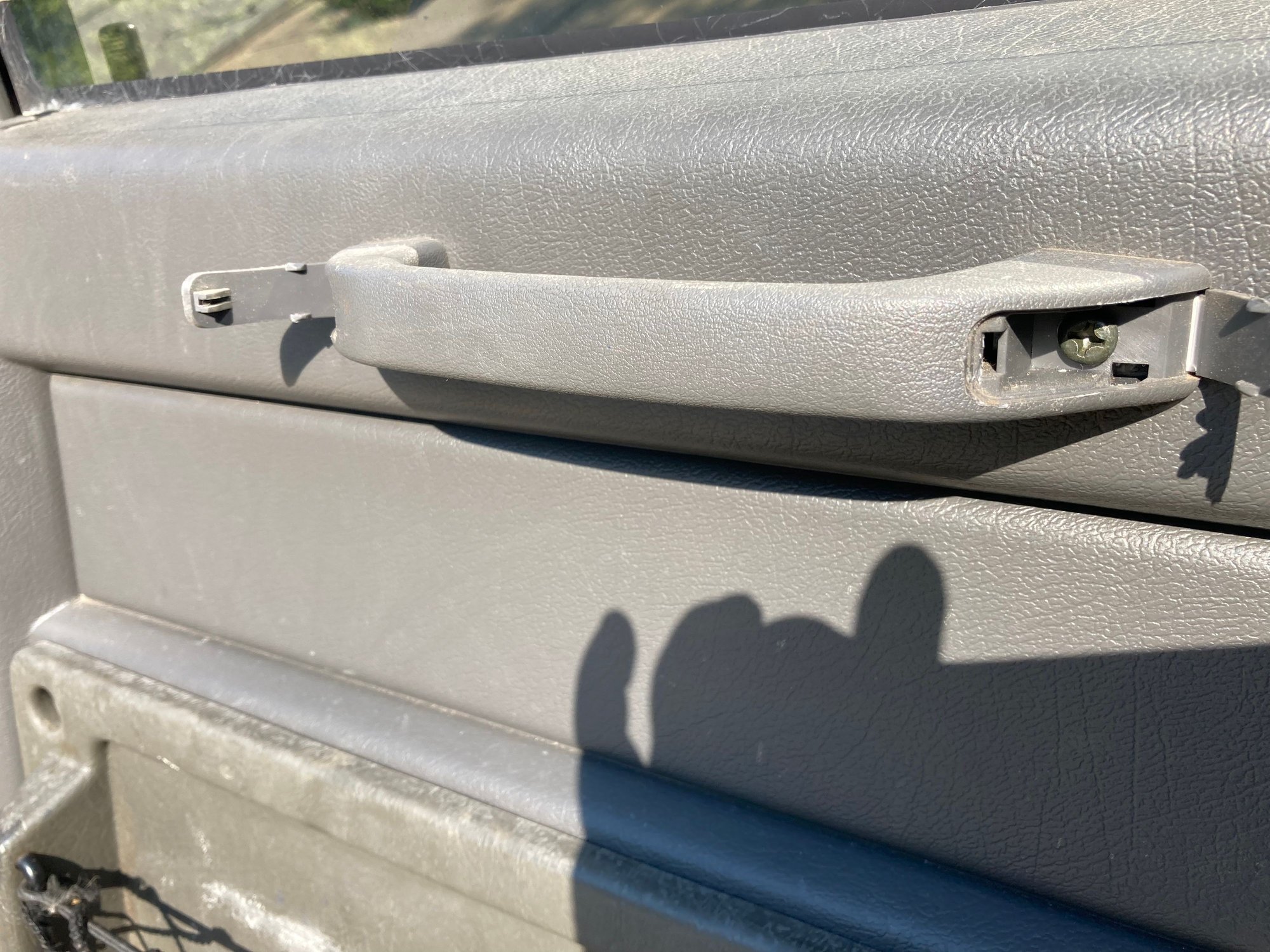

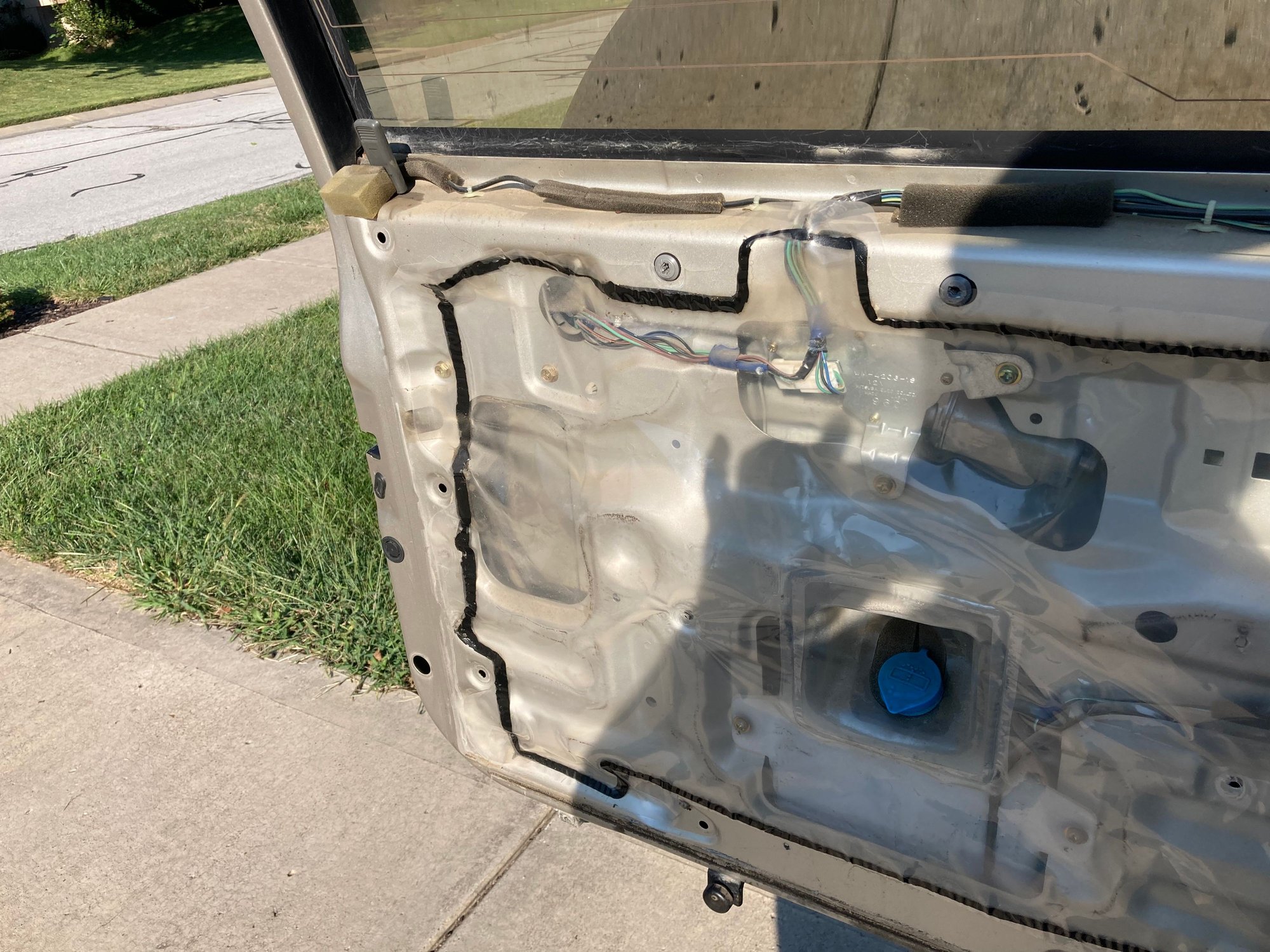

I started at the bottom corner with a flat putty knife and popped the clips off as I went around the panel. After that you see the clear plastic dust liner that I just tore off.
I flushed the mechanism with WD-40 and worked the key a bunch of times and buttered it back up.
Easy Peezy.
Flip up the two little plastic tabs and remove the screws holding the grab handle.
