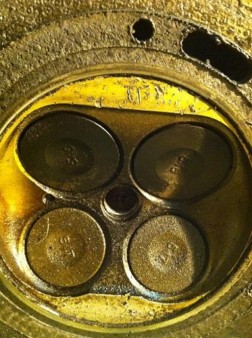

hi, this was my buddies wife's rig, it developed a horrible knocking sound so the took it to a honda dealer i believe and they told him it dropped a valve in the #6 cylinder and would cost in the neighborhood of $3000 to fix it. it sat for a while and now belongs to me, due to him not wanting it to sit in his yard any longer. he said it still ran, just made a horrible noise. i tore the top end off the engine w/o trying to start it first, know im kicking myself. anyway i cant find anything wrong with the engine, cylinders and pistons look good, turns nice felt like it had good compression while turning the engine over by hand valves and cams look great. there was definatly something in the #6 cylinder cause there is some marring on the head around the valves, but there was no spark plug in this cylinder when i started and am wondering if its possible that the plug broke and kicked around inside there till it was small enough to be expelled out the exhaust? i want to put it back together now but was wondering if there was anything that i should replace being its tore down this far anyway or anything else i should check that could produce that noise. also i did drain the oil and then strained it through a small screen but was clean didn't find anything. also any recommended rebuild kits for the top end would be great, i dont want to pull the motor or tear into the bottom end if i dont have to. thank you so much for your time and any insight you may have. also this pic is of the cylinder head i mentioned previously.

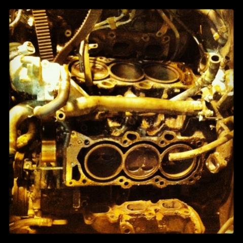

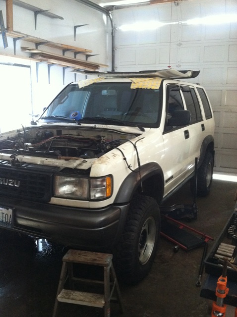

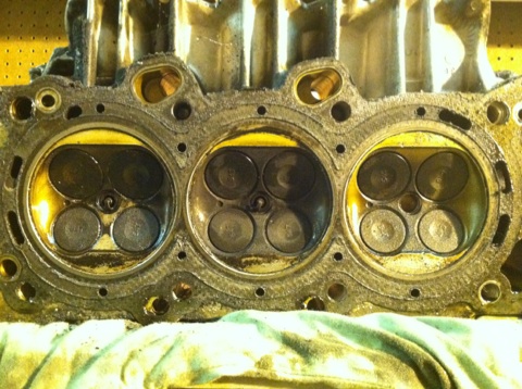

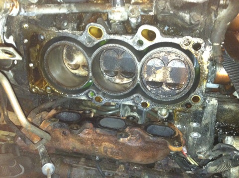

Default more pics
if there is an easier way to upload photos, please feel free to take me to school.
Attached Thumbnails 93 trooper 3.2 tear down and rebuild???-1000001162.jpg   93 trooper 3.2 tear down and rebuild???-1000001165.jpg   93 trooper 3.2 tear down and rebuild???-1000001169.jpg   93 trooper 3.2 tear down and rebuild???-1000001177.jpg
