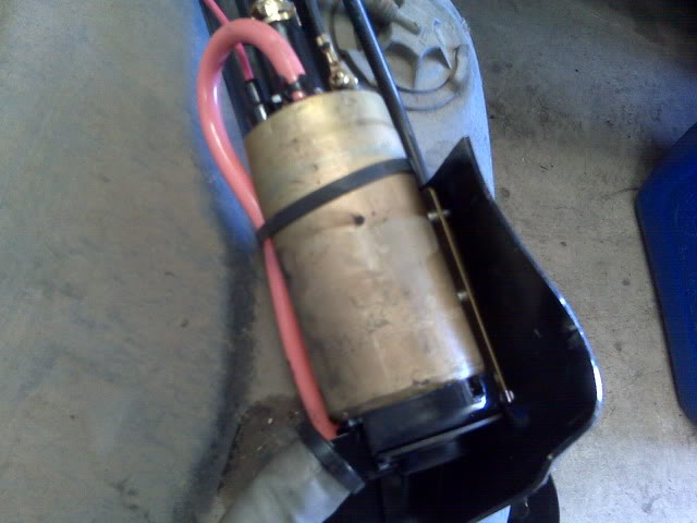

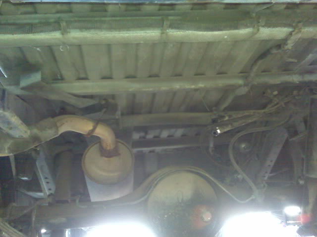

Heres some pics for reference....Mine is a 4 cyl Trooper but I dont think it matters:
