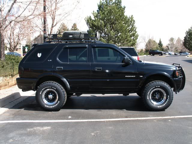

Toyota Tacoma wheel spacers work. Same bolt pattern and hub diameter. I wouldnt go more then 1.5"
''98+ rodeos have the smallest wheel openings of any isuzu. With stock wheel back spacing and no spacers you MIGHT be able to fit 31" tires. With spacers or aftermarket wheels 30" tires might rub. I had 30''s on my stock rims before I upgraded and they were fairly close. I now have aftermarket wheels with 3.75" back space and 32" tires and had to trim the fenders to fit them even with a 3" lift. I also had to lower the rear bumpstops 2" to keep the rears from rubbing.
The tires and rims..
The trimming...
