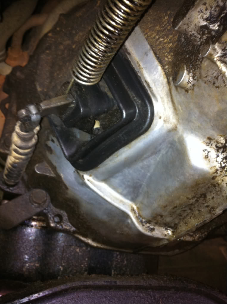

I have this little boot on the side of my 1987 Isuzu Trooper II's transmission. It has a spring on one side, its ripped and I want to replace it. however Autozone said they wouldn't have it. Anyone know what its called? I'm trying to find it, I'm sure ill end up having to find one at a junk yard. Thanks.

It's the clutch boot. You will not find one at any parts store, it's a dealer only item. I highly doubt you will ever find one of these in good condition. If you're lucky you may find oone that's better than yours, but all I've ever seen were torn to some degree. If you go the planetisuzoo forum or the isuzupup forum send a PM to JLemond, he has acces to new OEM parts and can get you a new one.
