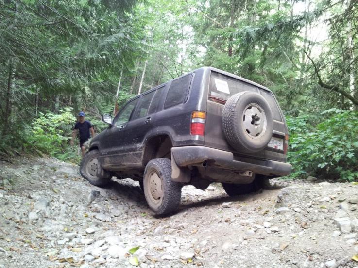

For anyone who has old saggy rear coils on their 92 and up Trooper, just want to let you know, you can use coils from a cherokee if you cut the top ring off. Tried it and it works great, gave me a one inch lift too. $30 for both at the wreckers.
