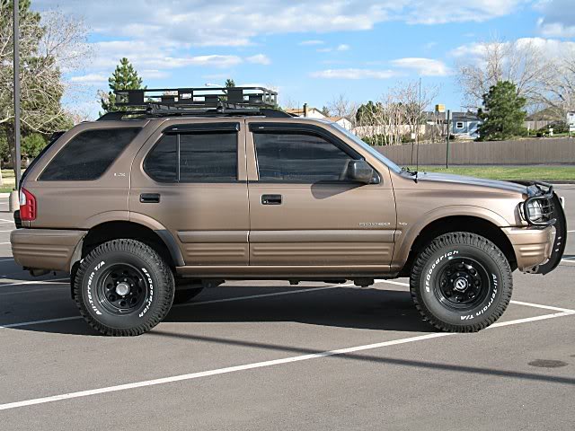

The biggest you can fit without a lift is 30x9.50, with a lift you can probably put 31x10.50 (would have to trim the fender a bit without lift). With a lift and a little bit of trimming of the fender you can put 32x12.50 which is as big as I would go with stock gearing. Can go larger with more fender trimming.
What needs to be trimmed is the very bottom of the back edge of the fenders. Its low enough that you cant notice unless you know its there. Oh, and a litte bit of the front fender plastic but again not noticable.
Here is a pic of one with 32's and 3" lift (not mine but I helped lift it and trim the fenders)..
Attachment 1236
If you look at the back edge of the wheel well opening where the mud flap would go you will see its kind of angled back a little bit instead of straight down. Thats what has to be trimmed to fit 32's. Also a seam inside the wheel well needs cut/ground/pounded flat but will never be seen. Wider wheels or ones that stick out farther would need more trimming then narrow and tuck in the fender. His wheels are 15x8 with 3.75" backspace.
